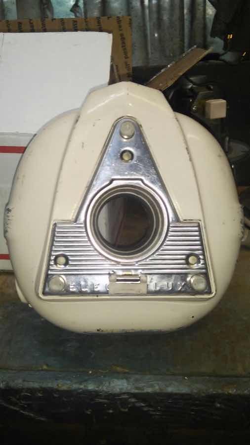

Hello, new here. I’m trying to restore my mothers Electrolux model F vacuum. I need a few parts, thought I might get lucky here. I need the original braided hose, 1 Front rubber bumper, switch , cord reel. I can’t seem to find a parts vac. Any help would be awesome. I’ll see if I can attach pics.
I just bought 2 alum tubes, but they have the wrong finish on.
I have the owners manual, and all the attachments.

Here’s a few pics. The hose does leak where it spins. There’s a gap in there.

Post# 431564 , Reply# 9   9/9/2020 at 20:39 (1,112 days old) by Jo (Dallas,TX)
Automatic control dial
The dial in the front regulates the sensitivity of the automatic control feature which pops the bag door open and shuts the cleaner off to signal you to check for a full bag. The machine constantly monitors the suction provided by the cleaner on both sides of the bag, before and after it, as the bag fills with dirt suction will be reduced as the dirt clogs the pores and the bag door will pop open when there is a significant imbalance of suction before and after the bag caused by the bag filling with dirt. A lower number setting makes the system very sensitive to a small loss of suction from a minimal amount of dirt in the bag and a higher number allows it to tolerate a higher loss of suction before popping open.
Fine dust such as powder, ash, and plaster dust will clog a bag’s pores very quickly causing a loss of suction even with the bag not full...and conversely, a bag full of pet hair doesn’t cut off much suction at all and could be stuffed before popping open. So if you need to vacuum fine dust you’ll need a higher number to complete the job without the machine continuing to pop open and for a job with coarse dirt such as pet hair you’ll want a lower number to make sure it signals when it’s full so you aren’t over packing the bag.
For an average home dirt usually 3 is a good number but I usually set my machine on 1 or 2 when I put a new bag in and when it pops open, if it’s not full enough to change I select the next higher number and close it and continue vacuuming until it pops open and is full enough to change the bag or I feel the cleaner has lost enough suction that warrants I put a new bag in to restore suction to peak. I like to use a lower setting for carpet so I insure I have the best suction always for carpet that it is not compromised by the bag filled. For hard floors the machine works well even at reduced suction so I will tolerate a higher setting which will allow for less suction efficiency as the bag fills so I can put more dirt in the bag.
Basically the dial adjusts how quickly the automatic “Check bag” feature occurs. Lower number advances its operation to most frequent and a higher number “retards” it’s operation so you can continue cleaning even though suction is getting blocked off by the dirt accumulation in the bag and fit more dirt in the bag.
It is recommended not to stuff the bag, but rather change it when 2/3 full to allow for good air flow to keep the motor cool and not run the machine at a strain due to blocked suction from a filled bag. The highest number 6 is really just if you are vacuuming fine powder and need to get the job done without it stopping, and then you should change the bag and reset the dial to a “regular” lower number when done.
Your manual should have a page explaining this but it doesn’t really tell you exactly how it works, just how to set it. It doesn’t tell you if it’s adjusting suction or not. It’s actually monitoring the cleaners suction at all times when it is on. Some people think it adjusts suction but it does not, it just allows the machine to operate at a higher amount of suction loss (Inefficiency) due to the bag filling with dirt on each higher numbered setting.
The nice thing is that this system is a constant performance monitor to constantly monitor the machines cleaning efficiency and signal when it is diminishing by the bag filling with dirt which depletes suction.
The first machine this system was introduced on was the model LX and it did not have an adjustment dial and people were going through too many bags too quickly, the addition of the dial allows the user to tweak the automatic control to their specific needs or composition of dirt in their home and also make an exception for a special job such as fine powdery dirt so one would not have to use a bunch of bags to get that type of dirt job completed.
A hint: if you do need to clean fine dust, setting your machine on 5 or 6 is ok for the job and if it pops open you can take the bag out and flick the sides or shake the bag down and reinsert, this will restore better suction as it will clear the bags sides of the powdery dirt and allow it to pile at the bottom of the bag and allow more of this dirt to be added to the bag.
I have one I use as a shop vac and on these types of jobs I usually do that to help restore the bags suction so I can get the task completed without having to change the bag. Sometimes I’ll do this 2 or 3 times before I change the bag but if it’s popping open on 6, it’s time to just change it for sure as running the machine in this state could wear out your motor prematurely.
The cordwinder can be rewound or if the spring coil has broken a new one is available from Aerus. The biggest thing you must pay attention to is that the spring be wound on a few times around so that when the cord is fully extended it doesn’t get pulled off the spool but not so little that it hampers the rewind strength. It takes experience to roll up a cord reel spring and assemble the whole thing and once it’s wound it has to be installed onto the base carefully and held to not unwind while doing so. The cordwinders contacts and raceway tracks should be cleaned and adjusted for good contact.
The switch yes has a rocker cover and a mechanism under it. Rumor is the mechanism is discontinued but I’m not certain of that for sure. The mechanism is pretty sturdy and can be cleaned if spark residue has built up.
You may want to search ebay for a model F for parts...it’s possible you may get some that way.
Looks like you have a plastic hose which should give you good suction performance.

Here’s the cord reel. I hope it all works like new when I get it back. I sent him the rubber stop part off the original.
The bumper on the door, is that just a push in or does the door have to come apart to install it?

That’s a model 2 cordwinder. It looks a bit beaten up like someone dropped the vac tilted up from the front on the pavement. When you get it back you might want to paint it With a matching paint so that scratched area won’t rust.
The cordwinder should have a plastic ring around the hole where the cord comes out. When I’ve had to open any of these, I usually flip the ring around as it wears down on the top side from the cord being dragged along it when pulling the cord out. It’s best though not to pull the cord out in an upward direction, but rather straight out so neither the plastic ring nor the cord itself suffer damage.
In the meantime an extension cord with a correct straight oriented female end will likely plug into the back end of the switch to give you a cord to run the machine sans cordwinder. This machine uses the same standard cord as the AE, R, and L so if you want one of them, you can search eBay for one and also get a cord halo and then you’ll have both the non cordwinder setup as well as the cordwinder equipped setup which you can swap out if you like. The cordwinder will add a significant amount of weight to the machine and I added one to my Mother’s L and then some years later she complained the machine was heavy so I converted back to no cordwinder and she was happy again. The cordwinder really wasn’t something she was concerned about having as much as a nice light weight heavy duty vacuum cleaner, which the Model L was touted as per the advertising on our box which she stored the unit in for many years until the box finally became kinda tattered and she decided it fit in the closet better without the box.
Jon

Yesterday I got good and bad news from Terry,
He said there is 3 diff types of the cord reels for the F’s, mine happens to be the middle version, it has larger parts inside and it’s missing half of them, the Electrolux guy my mom knew must have robbed some when the cord was put on directly. So in his stash, he has a reel in teal, and the later F version, also a few early versions with the band around, I liked the 3rd version, only diff is it has 3 little bumpers to sit on when you stand it. ( see pics). Mine is next to the teal unit, I opted fir the same unit not the teal. If I do have to re paint it, has anyone found a matching paint or do I get some enamel mixed at a automotive paint shop and mix in a prevail spray bomb?
Also he’s sending the front bumpers, I’ll put 2 good ones on.
It’s crazy how many differences there are for F’s.

The type two cord reel with the three little rubber feet is for the model R. It uses the same parts as the model G. The type two for the Automatic F used unique inner parts.
Post# 432203 , Reply# 54   9/21/2020 at 12:45 (1,100 days old) by detroitdirtbag (Bottom of the Bag)
detroitdirtbag's profile picture
Well crap, it it what it is. I’ll hang onto the OG one, maybe one day I’ll find parts.

I agree, so crazy the cord reels were changed but I guess F’s had the old cord reel first then the new one was introduced..then iit must have been quickly improved leaving us with the third version of parts which looks to have been identical with parts to the model L, R and G’s just different colors and I would say that’s the best one to go with because there were so many of those made so getting parts in the future would be less difficult.
I wonder if he can fit your new one with the flip open louvre? It’s a Nice touch and can be changed as I see the current one is broken off so just the tab remains. It directs the exhaust air upward so as not to blow any dust on the uncleaned portions of the floor around.
The first F I had...had the second version of the cordwinder I believe...it didn’t have the louver or the little plastic feet to stand on to avoid the metal from scraping the floor or the metal getting scuffed itself. My Brother ended up with that first F which actually belonged to a neighbor of ours. After his using it for several years the motor started smoking he said and so he threw it away several years ago. It may have had a black cord on it, that seems to sound familiar. It did not originally have the power nozzle power port.. But it did have the bumpers on the bag door. .I retrofitted the power nozzle port to it using a PN-1 teal sheath cord so it sounds like it was nearly identical to yours.
Funny thing is my Brother thought the cordwinder was the motor! He said the vacuum is so funny looking with the motor sticking out the back. I had to correct him and explain it was strictly the cordwinder and that was an option and that’s why it looked like that.
Electrolux was always working on improving the products so I’m not surprised things kept changing.

I got my parts from Terry yesterday, everything was nice. Even though the cord winder is off a later Vac, it matches. It came complete with the switch cord, I do have an extra from tan bumper if anyone needs one. I also got a cord halo not sure why, but I he had a few nice ones. My mom sure would be happy it’s all fixed up. It gets a retired life now just cleaning the finished floor in my garage. The sound just brings back memories, thanks to all who helped with questions here.
Terry is top shelf on parts and service. I’d recommend him for your Electrolux needs.
I need a tan vent for the winder. I’ll have to scour eBay.

I got the vent, it’s nice, but I’m missing a clip or something to hold it on ?

Vent clip
So look on your cordwinder...hopefully the clip and broken tab from the old vent is still there. It was in one of the pics of the cordwinder you posted here. What you will need to do is use a straight blade screwdriver in the center of the slot where the hinge is. You will see a cut out in the center. Put the screwdriver on the upper part of the bump out of the clip and push downward, the is will contract the spring clip and allow it to come out from under the metal trim. You will need to use this spring clip to hold the new vent on so don’t damage it or lose it.
To install you’ll throw away only the old broken off vent hinge tab and put the new vent’s hinge bar in the groove of the clip, and fit the bottom edge of the clip into the bottom of the slot on the back of the cordwinder first, then using the screwdriver push down on the clip bump out to contract it so the top fits into the slot edges.
Let me know if you have questions...

Post# 433671 , Reply# 134   10/17/2020 at 20:11 (1,074 days old) by Jo (Dallas,TX)
www.vacuumland.org/TD/JPE...
I copied and pasted this photo from your picture above, it shows the broken off vent tab and the clip. I did see a picture after this one that shows the cordwinder after Terry sent it to you without the clip and broken off vent hinge. I hope he didn’t take it off thinking he was doing good and not put the clip back in. If he did, perhaps you can ask him to mail you the clip Since It was originally with it and you need it. Since he is into restoring this stuff I doubt he would have thrown it away and can send it to you.

Post# 433675 , Reply# 135   10/17/2020 at 21:16 (1,074 days old) by detroitdirtbag (Bottom of the Bag)
He took the old clip out, he kind of does what he wants. I asked for my old winder back and he said he threw it out. Also he sent a tan switch when I asked fir gray.
The vent I just bought , is is broken?
Post# 433724 , Reply# 136   10/18/2020 at 11:34 (1,073 days old) by Jo (Dallas,TX)
No
The vent is not broken. I was looking at the picture of the cordwinder you posted that I am guessing was going to be the one he was going to send you. But clearly after he sent you that picture he took the clip out and the broken off old bent tab. I guess you can contact him and mention that the photo shows it and ask to buy the clip from him. Hopefully it would be cheap and he will respect your wish to have the part That was originally on the cordwinder photo he sent you initially to complete your restoration rather than taking off the part and keeping it. Without the clip you won’t be able to attach the vent.
I’d contact him for sure to see if you can get it letting him know you have obtained the correct vent louver but need the clip back that appeared to be on the winder before he sent it to you.

Post# 433775 , Reply# 138   10/19/2020 at 08:04 (1,073 days old) by detroitdirtbag (Bottom of the Bag)
What does the part look like I’m looking for to hold the vent on ?

Post# 433782 , Reply# 141   10/19/2020 at 11:02 (1,072 days old) by Jo (Dallas,TX)
Here’s an ides
It is basically a rectangular flat piece of spring steel that has a hump across the middle of it longways, this hump forms the place where it goes over the hinging plastic rod of the vent itself. It is just about as wide as the slot in the back of the cordwinder. You can see the hump in it from that one pic I copied above.
Jon
