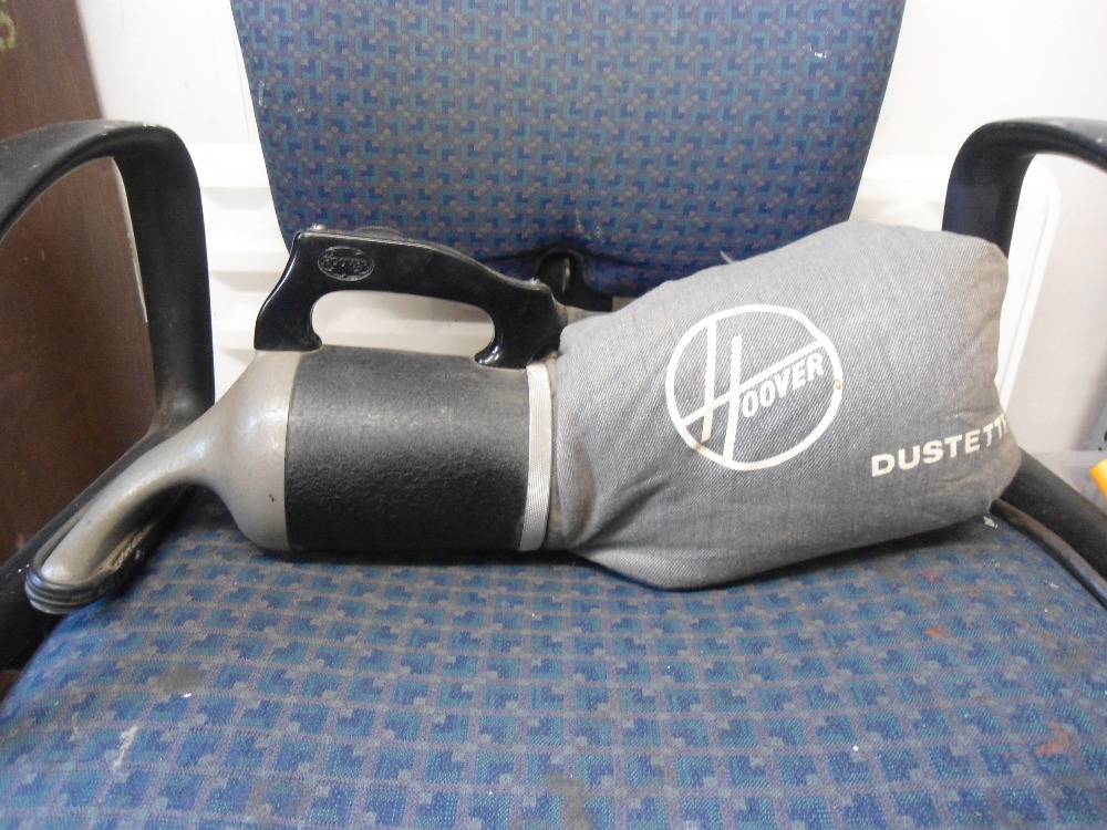

Post# 171100 , Reply# 4   2/27/2012 at 11:43 (4,229 days old) by juniorsenior ()
Here is a couple of pictures of said Dustette.

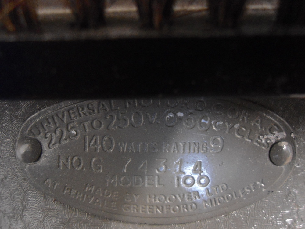

Post# 171101 , Reply# 5   2/27/2012 at 11:45 (4,229 days old) by juniorsenior ()
A d serial number.

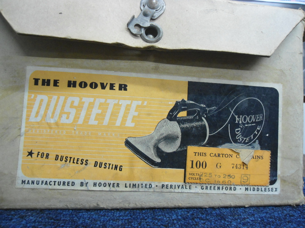

Post# 171102 , Reply# 6   2/27/2012 at 11:47 (4,229 days old) by juniorsenior ()
And box
Post# 171107 , Reply# 7   2/27/2012 at 12:12 (4,229 days old) by twocvbloke ()
I've got a bag somewhere that would probably fit that (not sure though cos I don't know those vacs at all), in dusty blue, cos someone forgot to empty it before chucking it into a box of spares I got last year... :P
Post# 171109 , Reply# 8   2/27/2012 at 12:16 (4,229 days old) by juniorsenior ()
My pal hadnt even tried this out till he brought into my work today and it was filthy and the bad was full of dust, He has left it with me for a few days and i,ll clean it up a bit for him.

Post# 171250 , Reply# 10   2/28/2012 at 13:53 (4,228 days old) by vacbear58 (Sutton In Ashfield & London)
Dating
vacbear58's profile picture
With that colour scheme it is pre-1950. The picture on the box shows the earlier style with a rocker switch but this is the later version - I would suspect that this would be pre-war, but sorry cannot be more specific than that

I was looking at this Dustette and am beginning to think this has been painted at some point.

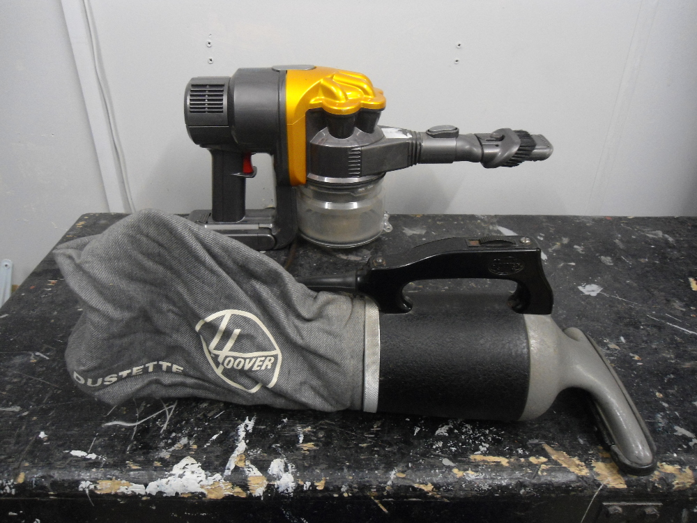

Post# 171363 , Reply# 17   2/29/2012 at 13:09 (4,227 days old) by juniorsenior ()
Old and new together.
Post# 171366 , Reply# 18   2/29/2012 at 13:44 (4,227 days old) by vacbear58 (Sutton In Ashfield & London)
Painted?
Dont think so mate, it looks like later production of teh first version. bag is a replacment though
Post# 171368 , Reply# 19   2/29/2012 at 14:01 (4,227 days old) by whirlpolf ()
old and new
nice thread, have a similar Dustette as well (but more bronze coloured), but this Dyson?
Surely a handy and strong vac (tried in once, nice on-off behaviour, is on 100% in no time), but the Dustette clearly wins at "looking like a real vacuum" (bag, nozzle, blower casing etc.).
The Dyson somehow cannot decide what to morph into next:
A coffeemaker? (the coffeepot dustpan)
A "Transformers" style raven's claw? (the yellow fangs on top)
A hairdryer? (that motor compartment)
A drill? (That DIY shop pistol grip)
Somehow, I expect it to twitch or move any second. Odd...
Futuristic is one thing, a split personality another (just my opinion).
Mind you: Talking about the looks here, not about the vac itself.

There is traces of grey paint on the rubber guard and i thought the serial number plate was in bare metal rather than painted but i dont know anything of its history i am just trying to find some info for a pal, i did think it was a replacement bag thanks for confirming, i take it the box has the picture of the correct bag?
Post# 172012 , Reply# 21   3/5/2012 at 13:20 (4,222 days old) by juniorsenior ()
So can anyone date this from the box photo?
