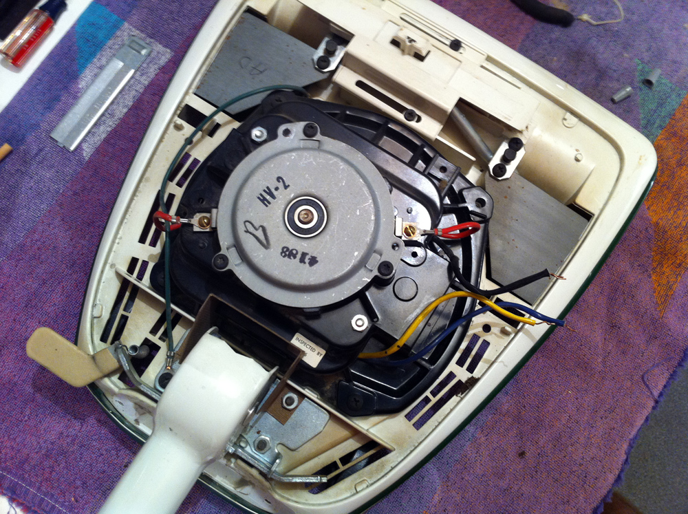

Post# 141853 , Reply# 1   7/3/2011 at 09:36 (5,013 days old) by HooverCelebrity (Germany)
Taking it apart...
It wasn't too bad... but it stinks of cigarettes... so, apart it comes.

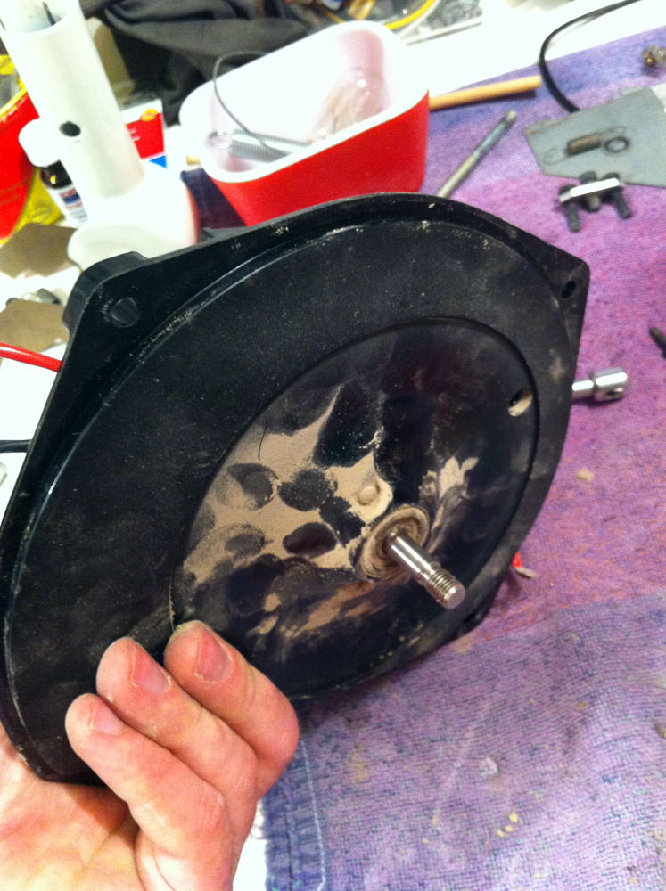

Post# 141855 , Reply# 3   7/3/2011 at 09:43 (5,013 days old) by HooverCelebrity (Germany)
The underside...
Looks like this motor was pressed together in a big giant press.
**grumble**
But I could swear that this is like new Sanitaire motors that have service parts readily available... so they must be serviceable somehow!

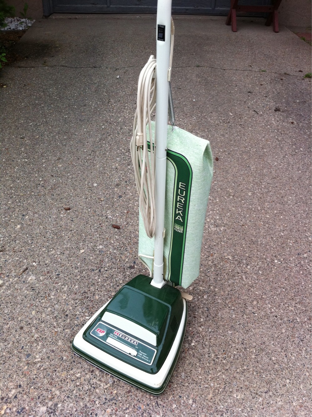

Post# 142180 , Reply# 9   7/6/2011 at 17:34 (5,009 days old) by floor-a-matic (somewhere)
Nice Eureka ESP
Eureka ESPs are also my dream vacs. When I was a kid, we had a burgundy mdl (now my sister's vac) I really love the way the ESPs clean.
