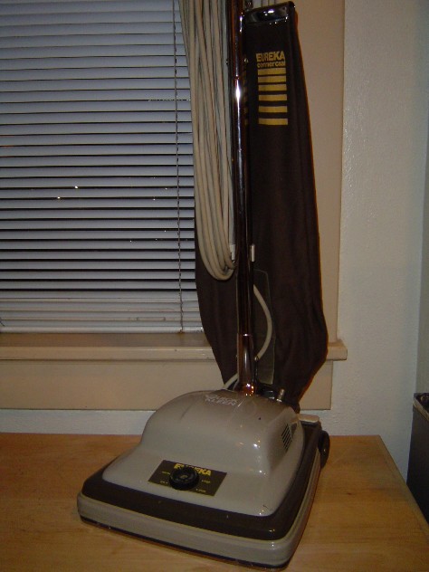

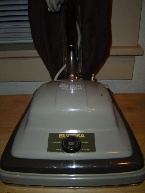

Next we have this unusual (to me) commercial model...
Post# 30871 , Reply# 5   2/3/2008 at 22:33 (6,260 days old) by swingette ()
I like cloth bag vacuums. I like commercial vacuums. I have never seen a Eureka quite like this one. I wonder when these were sold?
Post# 30872 , Reply# 6   2/3/2008 at 22:35 (6,260 days old) by swingette ()
I have never had a Eureka that had a brushroll mount like this does. Very Hoover-esque.
Post# 30873 , Reply# 7   2/3/2008 at 22:43 (6,260 days old) by swingette ()
This machine was obviously never used commercially. I changed out the Quick-Kleen fan chamber just for fun, but the fan was in such good condition that i left it as-is. I'm surprised to see an older Eureka (whens the last time Eureka used that hood shape!?) with a Quick-Kleen fan chamber.
Notice the agitator... uh.. i mean Disturbulator with "lifetime lubricated ball bearings" and "over 20,000 beats per minute"! Hoover could never boast as much!
Post# 30874 , Reply# 8   2/3/2008 at 22:44 (6,260 days old) by swingette ()

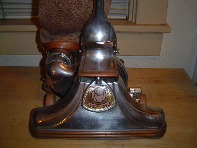

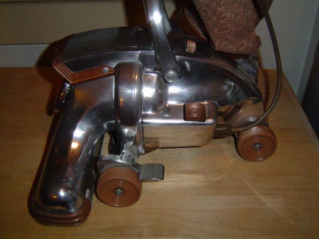

Next we move on to this old thing...
Post# 30875 , Reply# 9   2/3/2008 at 22:50 (6,260 days old) by swingette ()
A side view...
HELP!!! The motor sounds SLIGHTLY dry but i cant get the spindle and fan off to save my life!! Kirby gurus, i need your help!!

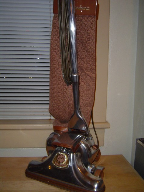

Post# 30876 , Reply# 10   2/3/2008 at 22:56 (6,260 days old) by swingette ()
The Glamour Pose. The 70s and 80s Kirbys are kinda hideous, but these are kinda nice.
I paid 11.99 at Goodwill. Soo much $$ for just a Kirby (lol)...

PS - I'd offer Kirby dismantling advice, but I've never actually had the motor of a Kirby apart... sorry!

That is one gorgeous Sani-VII, and I like the commercial Eureka too. I noticed that the rear wheels are outset so must not be all that old? Really nice finds and the prices were certainly right!

Getting the Fan off the Kirby...
Sometimes when I can't seem to get a fan off a Kirby like that, I use an ice pick. On the armature shaft inside the motor, there is a little hole in it. It's just about the size of an ice pick. You can see it through the hole in the motor housing(with the back cover off, of course). Stick the ice pick through that hole and then try turning the fan the correct way to get it off. If that doesn't work you may have to try to get a hold of the armature shaft with pliers or something like that. I've had many Kirby's apart like the one you have and I don't think I ever couldn't get the fan off. Hope this helps and congrats on your new finds.
Chad
Post# 30888 , Reply# 14   2/4/2008 at 07:32 (6,260 days old) by swiveltop (Galveston, TX)
Kirby Fan
I worked for a Kirby dealer when I was 14 back in '79 doing all the repairs,Usually the fan was already broken,so the first thing I would do is hit it sharply with a hammer in the right direction and that usually worked,if it didn't the fan is broken by now,so on the older machines you could break off a piece of the fan to get to the screws behind it that hold the front plate on,so you can pull the Armature out so you can get a grip on it,we had a special tool to hold the armature, while it was in the machine,but you risked damaging the armature,the fans were cheap to replace. Mark

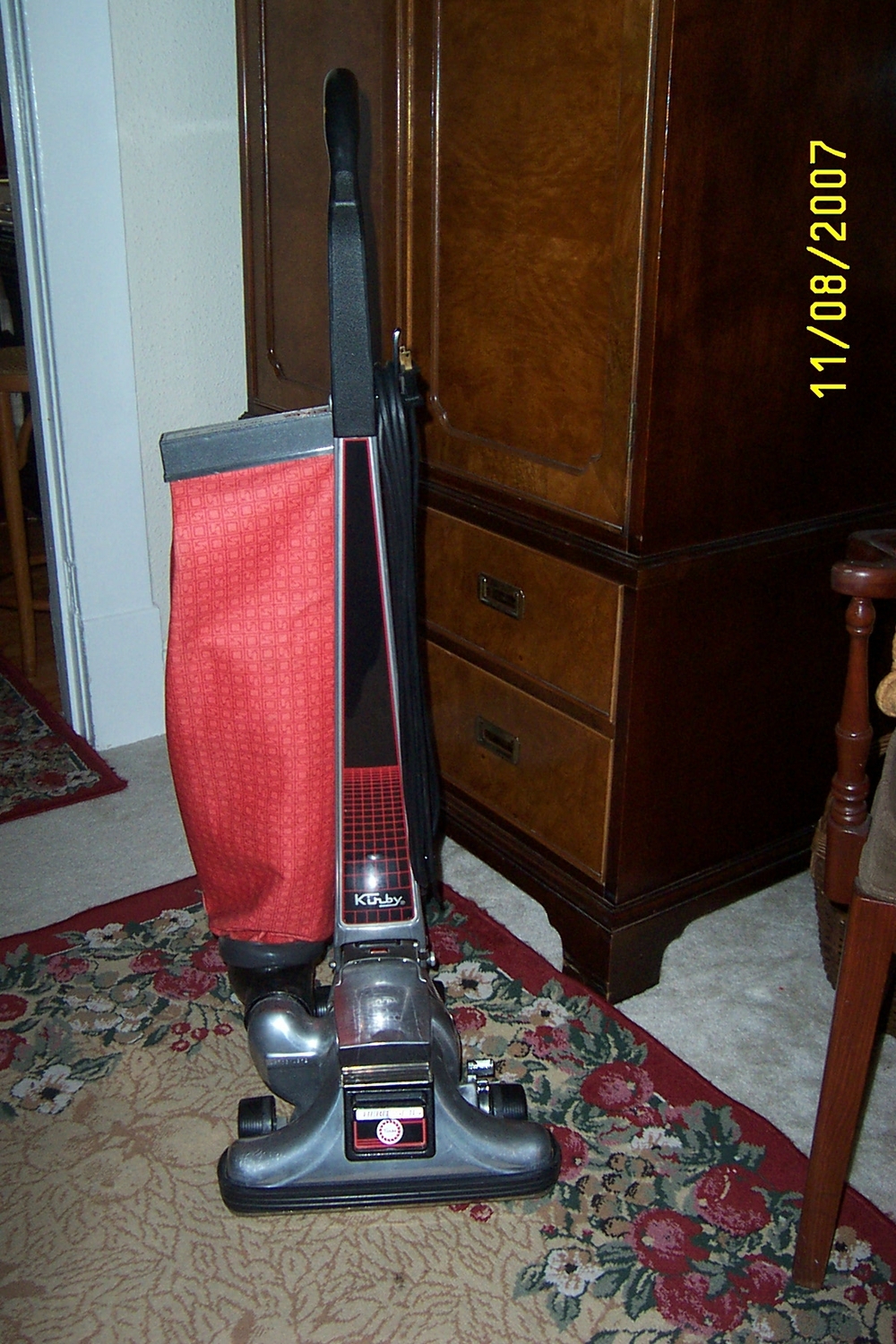

Post# 30892 , Reply# 16   2/4/2008 at 08:32 (6,259 days old) by swiveltop (Galveston, TX)
The wide Heritage Two wheels make it real balanced

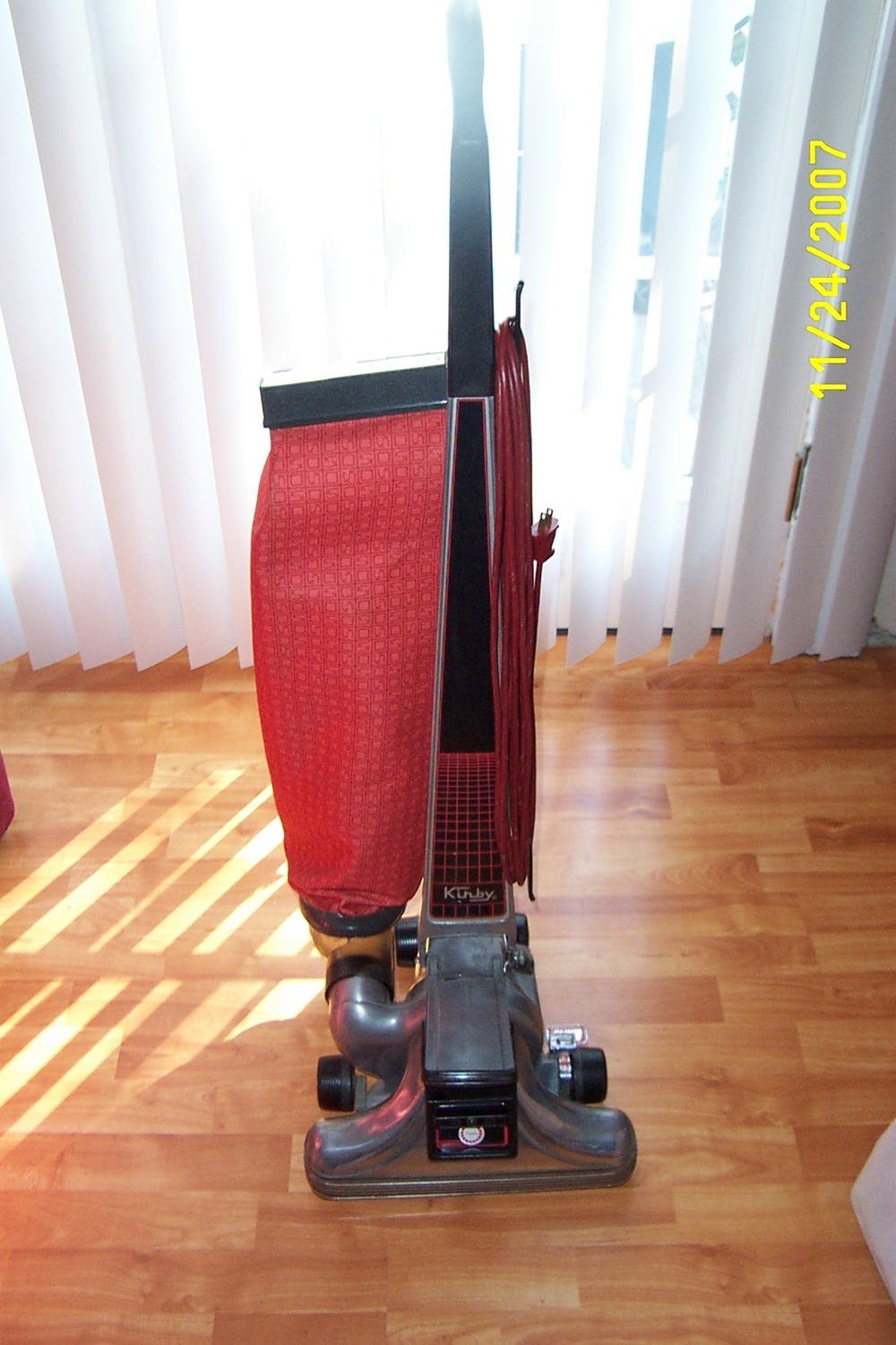

Post# 30893 , Reply# 17   2/4/2008 at 08:44 (6,259 days old) by swiveltop (Galveston, TX)
And here is my Heritage Two with the optional small head,my favorite,I have the original bag but I like the Heritage bag better. Mark

how many amps is the eureka commercial?
Post# 30941 , Reply# 22   2/4/2008 at 22:08 (6,259 days old) by normvac (COLUMBUS, OHIO)
Look at the fan to see if there is a hole in the front of the
stem (where the belt would go) you can put liquid wrench in it
and tilt the vacuum so that the liquid runs down, toward the armature shaft. So that it will soak the thread and help the fan release from the armature shaft, while you hold
the ice pick in the Armature shaft on, the commutor end (behind the bearing plate) to keep it from turning!

the commercial Eureka is 6.5 amps. it has outrageous power, perhaps too much. IMO the 6.5 and 7 amp Eurekas have too much suction. i got it (on eBay) for looks!
thanks for all the Kirby help, guys. this machine has really grown on me. i was surprised by the good airflow of this machine, and how quiet it runs. i will lay off trying to service the bearings for now, since they have quieted down since i first used it. the last thing i wanna do is break the fan and im not sure i want a plastic fan in it.

VERY NICE KIRBY
Brett Sometimes if it has not been used for a while the bearings just need to work in. If it is working fine and sounding fine LEAVE IT ALONE. Nothing wrong with a metal fan. Just be care ful of what you vacuum. Take care Doug

Re: Replies 4-5-6-7
Eureka Commercial Model 2037 with Quick Kleen
May 1985 newspaper ad
Post# 475997 , Reply# 27   3/13/2025 at 11:08 by Human (Pines of Carolina)
Resurrecting an almost 20-year-old thread...
I'm guessing perhaps that Eureka Commercial might be a forerunner of the blue Professional series Sanitaires, or it could simply be a rebadged Sanitaire, sold through a different channel under the Eureka brand.
