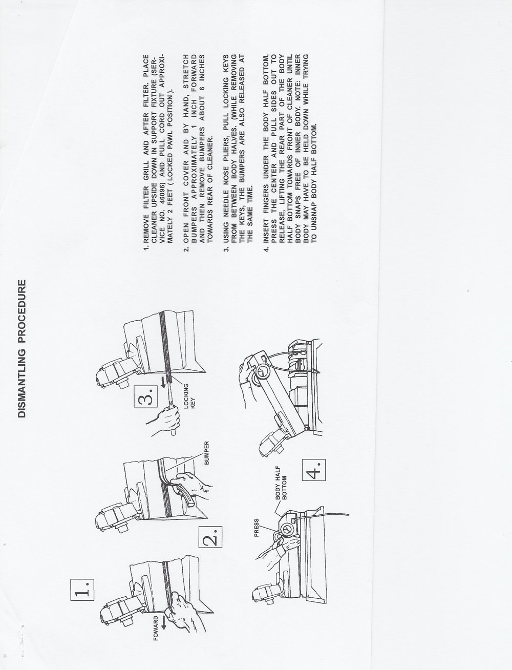

Jimmy told me on a previous thread that it is best to take these apart face down. Then you won't have to disconnect the wires on the top. I found out the hard way when I first took one apart with the control panel on top. After the tank is disassembled, check to see if all the hoses are connected and clear. Those later Elux plastic tanks seem to have a lot of power.

Great vacuum but the whole control valve set up in there is useless. Worked great in the metal tanks. Rather than replace it or I try to repair it I just remove the tube going from the control valve to the switch block. Then it can't shut off. The motor has a thermal switch so it's not needed to protect the motor in the event of a clog. And we are all smart enough to know when the bag needs changing.
It is best to remove the bottom from the rest of the vacuum and not the top cover. Once the bottom is off just move the bag chamber out and the valve switch and all the little tubes are right there.
