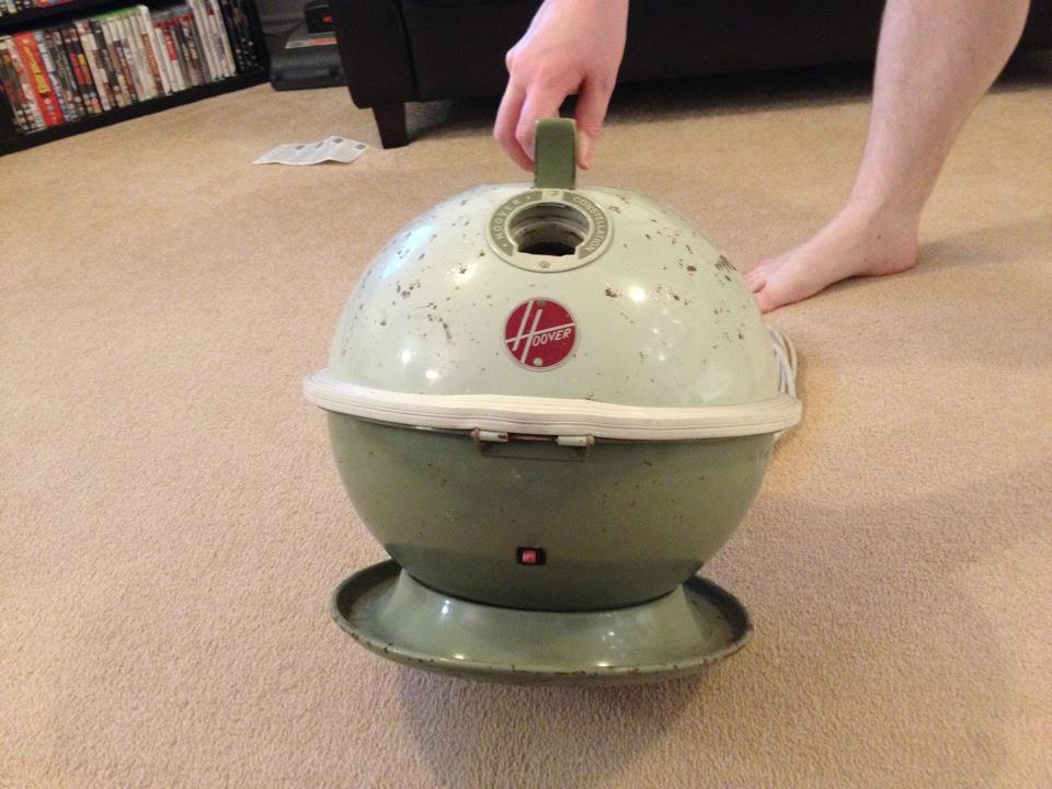

My partner was recently given a lovely little swedish green and smoked pine Constellation thats in need of restoration. My question is, has anyone been able to successfully match up the paint colour and if so how? does anyone know what the codes are?

Oh my! Beautiful Connie!
That color over here was called Garland green (the lower half) (my favorite shade of hoover green!)
The pale green... Not sure on that one.

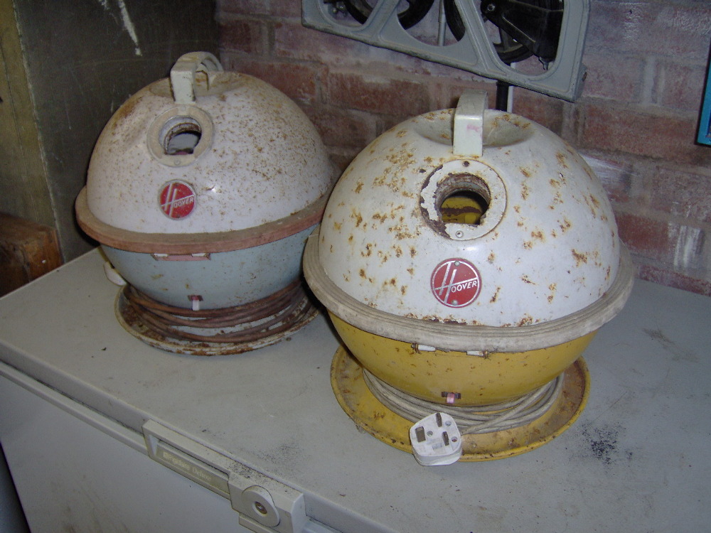

As Gareth has suggested a car body shop would get a close match, or a powder coater could get closer.
I go to a powder coater who shot blasts then re-powder coats.
Rust bucket

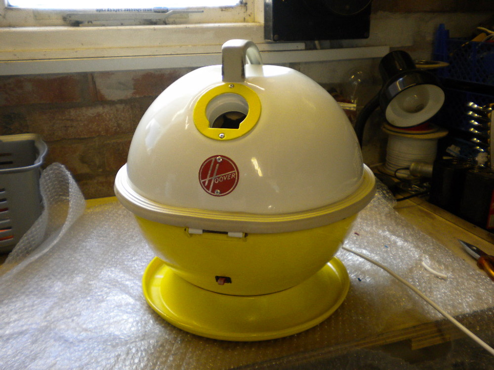

Post# 190328 , Reply# 5   7/17/2012 at 12:52 (4,153 days old) by hotpoint95622 (Powys, UK)
Hoover Constellation
hotpoint95622's profile picture
Just like new

that yellow one is STUNNING! fantastic job

Lee 'wow that yellow one is the best so far, I like the fact that you coloured the inlet ring too, looks lovely
